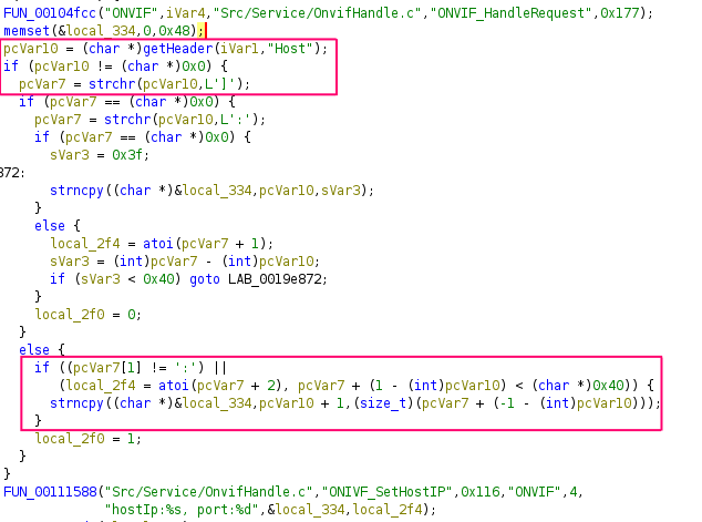

Vulnerability 1: Stack-Based Buffer Overflow in ONVIF Protocol Handler (CVE-2025-31700)
The ONVIF request handler on port 80 (function at 0x19e530) parses the Host header incorrectly, leading to an unbounded copy of the header on the stack. If the header contains a ‘]’ character that is not followed by a ‘:’ character, the strncpy function gets the size by subtracting the buffer’s address from the address of the ‘]’ character. This allows an attacker to write an arbitrary number of bytes to the stack, as long as the payload does not contain a ‘]’ character or a null byte. This oversight allows for an unauthenticated stack-based buffer overflow, ultimately overwriting the return address and several CPU registers (r4–r11).
The strncpy call at 0x0019e898:

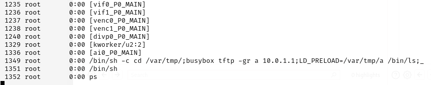

Exploitation is possible without prior authentication, and a successful attack results in full code execution. The proof-of-concept (PoC) developed by researchers shows the attacker writing system commands into memory and then invoking them through carefully crafted return-oriented programming (ROP) chains. The PoC drops an ELF payload using tftp and spawns a bind shell on port 4444 using LD_PRELOAD, bypassing binary signature checks.

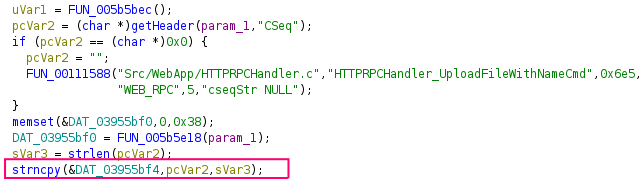

Vulnerability 2: .bss Segment Overflow via RPC Upload Handler (CVE-2025-31701)
A second vulnerability exists in the handler for the undocumented endpoint POST /RPC2_UploadFileWithName/*. Here, the camera copies the Cseq HTTP header directly into a buffer located in the .bss memory section using a flawed strncpy implementation.
The strncpy call at 0x00583948:

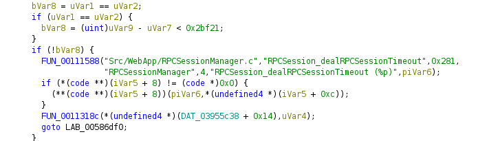

The variable at 0x03955c38 stores a pointer to a structure that can be overwritten by strncpy. The functions at 0x00586dd4 and 0x00586d18 continuously check this structure for expired sessions. Because no bounds checking is performed, an attacker can overwrite adjacent global variables, including a structure that stores pointers to session management functions. These are routinely invoked by the firmware to manage timeouts. By planting a crafted structure in memory, the attacker can redirect execution to a call to system(), again resulting in full remote code execution—no authentication needed.
Function 0x00586dd4 using a function pointer from the controlled structure:

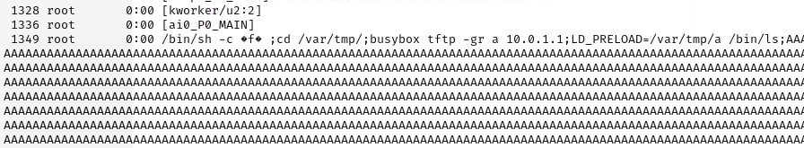

This exploit is similarly demonstrated in a PoC which uses a long header value to overflow the target structure and redirect execution.
