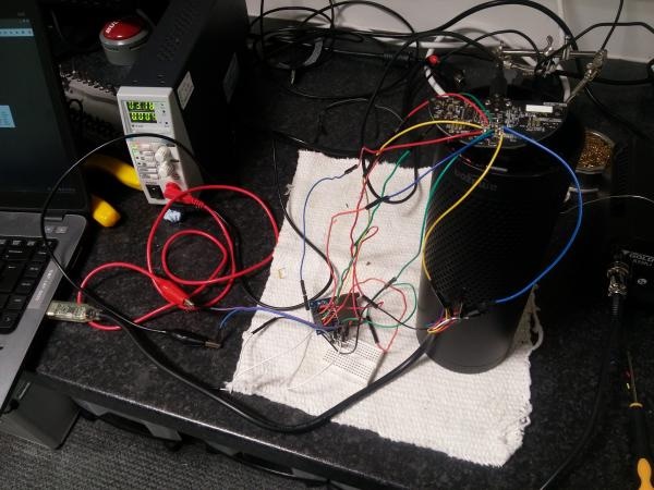

Security researchers have discovered that the Amazon Echo is vulnerable to attacks that could allow a hacker to install malware capable of secretly spying on the device’s microphone to hear what is being said in its vicinity.
In a technical blog post, researchers at MWR have described how they were able to exploit hardware design choices in the 2015 and 2016 editions of Amazon’s Echo home assistant to turn it into a covert listening device.
Conveniently for any attacker attempting to spy on a target without their permission, the attack does not affect the Amazon Echo’s overall functionality – meaning that to the victim the device will appear to be working sas normal.
Less conveniently for any wannabe snoop, the attack requires physical access to the device: the rubber base of the Amazon Echo must be removed tio expose debug pads, allowing the device to be booted from an external SD card.
If an attacker manages to gain access to an Amazon Echo of interest they can directly boot into the device’s firmware from an external SD card, gain remote root shell access and install malware that remotely snoops on the ‘always listening’ microphones.
