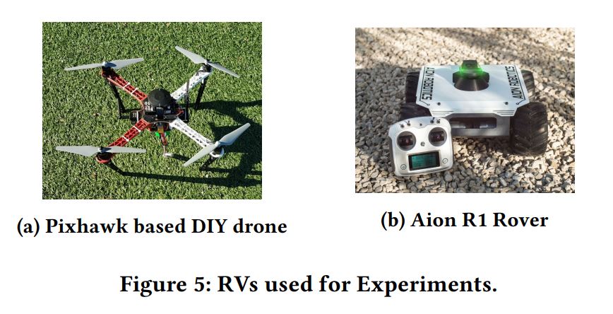

The RVs used for the experiments include a Pixhawk-based DIY drone and the Aion R1 rover, pictured below.
