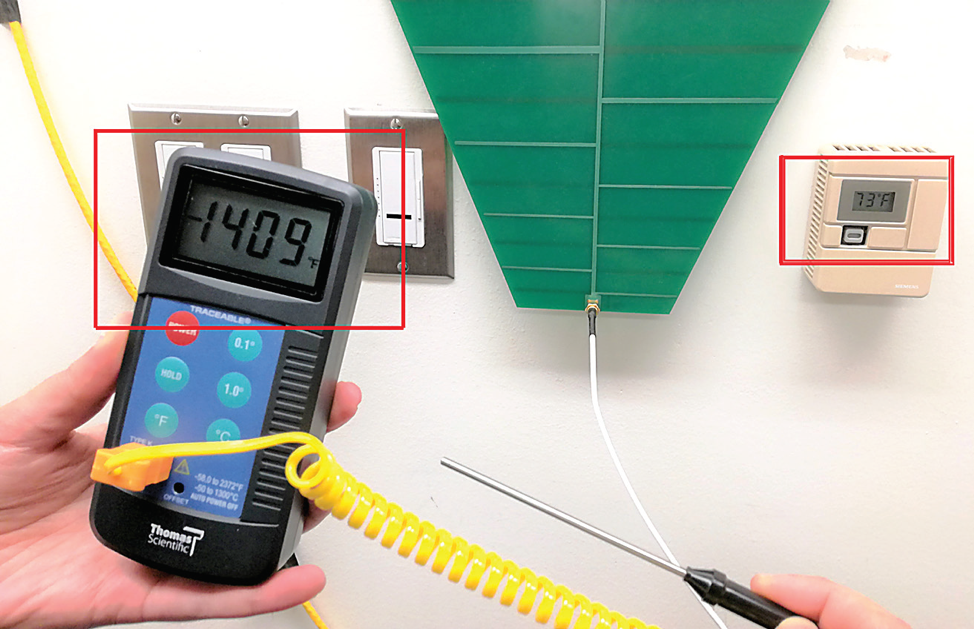

They offer the example of malicious electromagnetic waves hitting a temperature-measuring sensor, causing it to show a value of -1409F, which is 527K below absolute zero. A thermostat on a wall in the background shows the ambient temperature was actually a human-friendly 73F. In a similar experiment, the researchers were able to influence the data output of an accelerometer in a smartphone by playing sounds embedded in a YouTube video.
