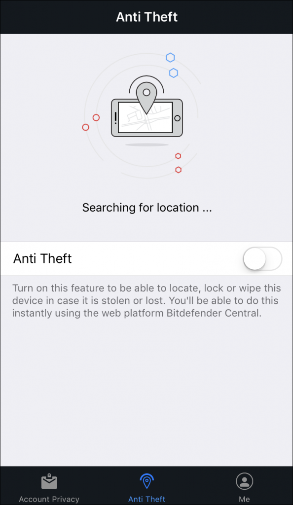

To enable Anti-Theft features, follow these steps:
1. Tap the
icon from the bottom of the screen.
2. Enable the switch.

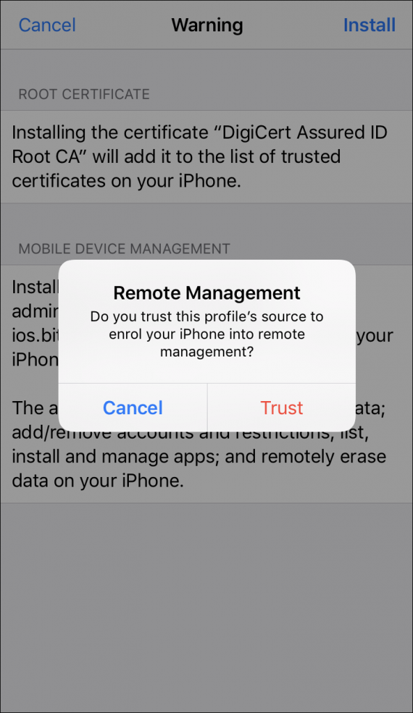

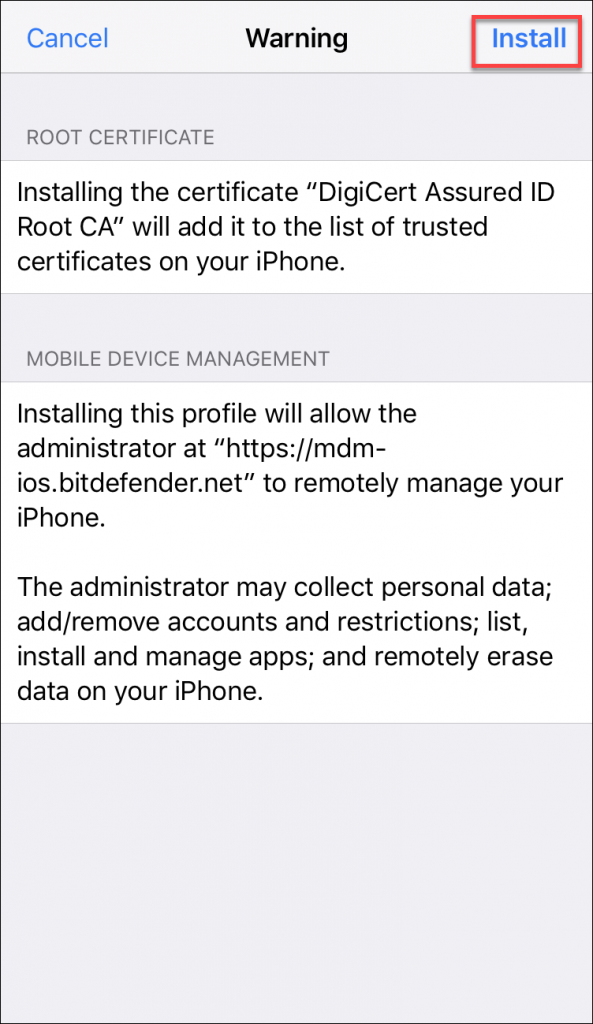

3. Tap Allow to install a MDM (Mobile Device Management) profile that Bitdefender needs to continue the activation process, then click Install.
4. Click Trust.
5. Type the PIN code you set to protect your smartphone to allow Bitdefender to install its files.
