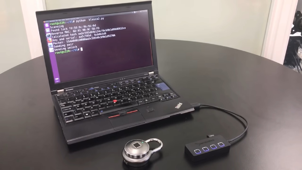

Researchers have found the so-called smart padlock has a major flaw. The accompanying smartphone app allows users to “share” the lock with someone else, including temporarily. The creators of Tapplock say users can revoke permissions at any time. However, Andrew Tierney of Pen Test Partners proved that, if you retrieve the necessary data before revoking permissions, you can use it to unlock the padlock in the future, even if your permissions have been revoked.
“The app allows you to ‘share’ the lock with someone else, revoking permissions at a later date,” Andrew writes. “I shared the lock with another user, and sniffed the BLE data. It was identical to the normal unlocking data. Even if you revoke permissions, you have already given the other user all the information they need to authenticate with the lock, in perpetuity.”
The attack – once all the necessary data is sniffed and the hacking setup is complete – takes a mere two seconds, as shown in the video below.
