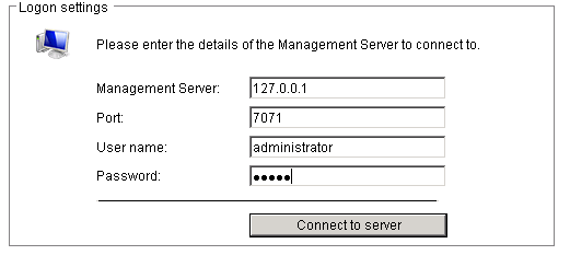

          2.  The Bitdefender Management Server service is stopped or the port value is incorrect  - even if this error message is explicit, we strongly recommend you to make sure of the following:
          a)  The login details you have entered are correct; If the management server is on the same machine as with the management console, the correct IP is; else, the correct IP will be the same with the target machine: e.g.; the username will always be administrator;
Bitdefender Management Console
